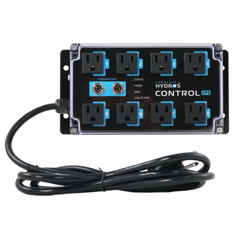

Device Features
  • Command Bus Ports (Blue): 2
  • 120V AC Outlets: 8
    • Max Load: 8A each.
Important Information:
  • Max Total Load: 14A
  • WiFi Compatibility: 2.4GHz ONLY
  • IP Rating: 30 (dustproof ONLY – NOT waterproof)
  • Mounting Bracket: Yes
    WARNING: Mount the device permanently to an elevated wall or side panel. NEVER place the unit on the floor. Ensure all cables have proper drip loops.
