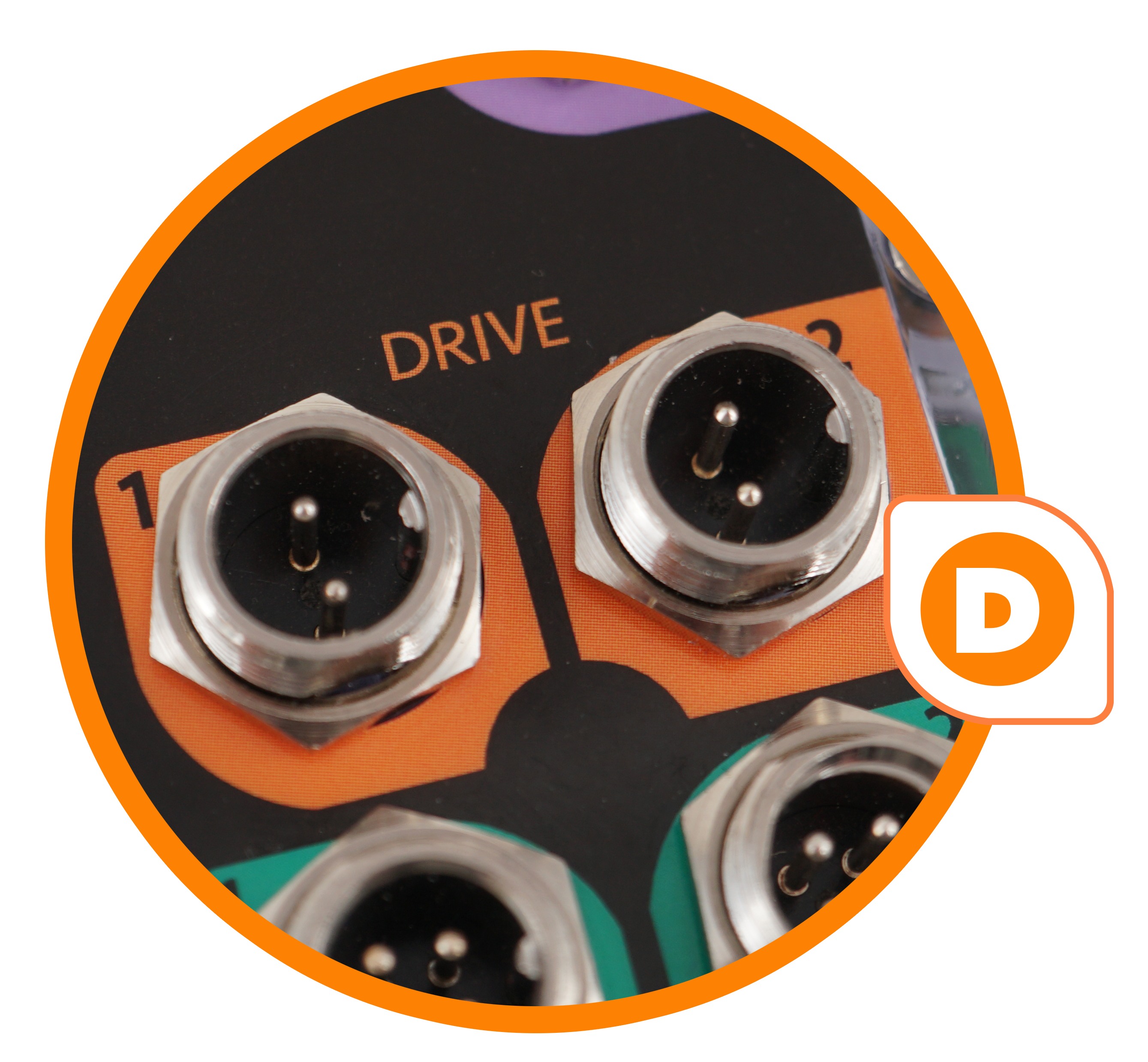

A Drive Port is a universal output port that provides switched 12v DC power to run all kinds of devices like small motors, pumps, fans, and even low wattage lights!

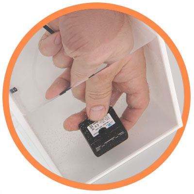

Install Drive Port Accessory in appropriate and desired location.

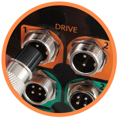

Connect Drive Port accessory to any available orange Drive Port.

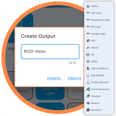

1. Enter Output Name
2. Select Output Type
3. Set-up Drive Settings

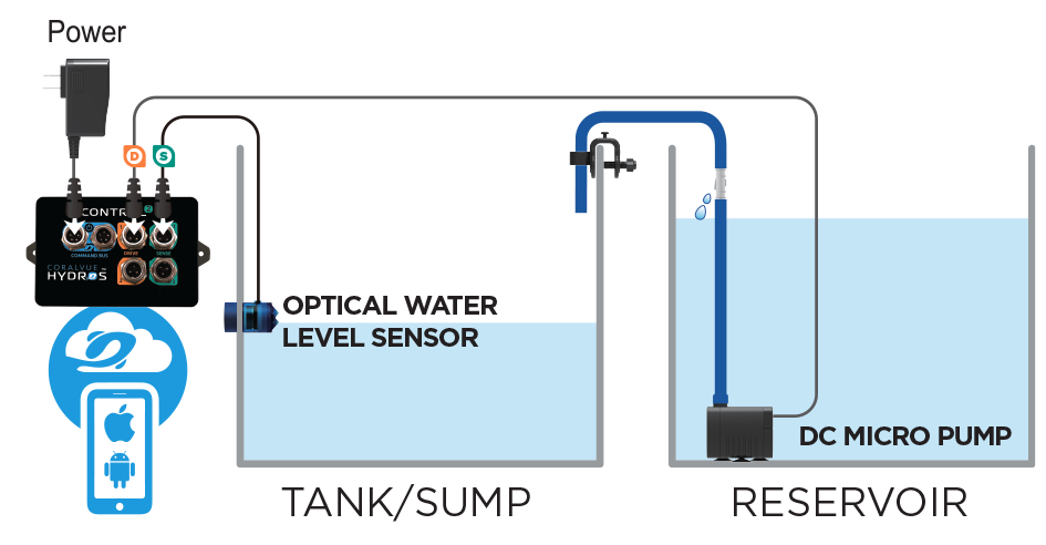

The HYDROS DC Micro Pump measures 1.6” L x 1.062” W x 1.45” H. This 12V brushless pump draws a maximum of 4.5W and a flow rate of 74-gallons per hour with a maximum head pressure of 8ft. When connected to a Drive Port on the HYDROS controller, it will supply power to the pump without the need for additional cords or power bricks. Using a HYDROS aquarium controller for your auto top-off system is not only a reliable solution but it also helps clear wire clutter in and around your aquarium.
Instead of using the DC Micro Pump above as your ATO pump, you can use the HYDROS DC Solenoid Valve instead. Just plug it into any Drive Port to power and control within the HYDROS app.

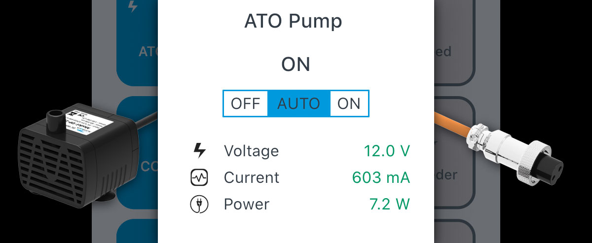

Get instant notifications when the current supplied to the drive ports either suddenly stops or draws too much!
