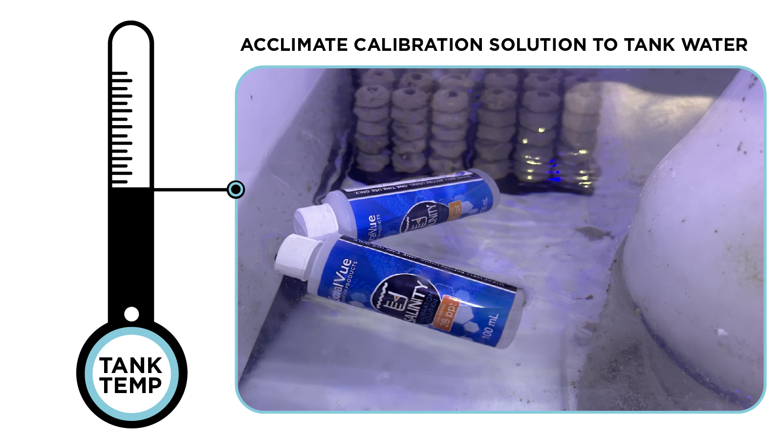

Sometimes, based on the quality and age of the Conductivity probe, the HYDROS Controller might need to be calibrated to the probe’s skewed voltage reading.   To calibrate, you will need the following:
  • Conductivity probe
  • Calibration fluids 28PPT and 35PPT at tank temperature
TIP: Q: Why does HYDROS use two-point calibration?
A: Two-point calibration is superior to single-point calibration because it accounts for non-linearities and improves accuracy. Using two reference points, typically at the minimum and maximum measurement range, the calibration curve can be more accurately modeled and interpolated, resulting in more precise measurements throughout the range. This approach provides higher confidence in the instrument’s readings, reducing potential errors and enhancing overall measurement reliability.
  1. If there is a small storage container, remove it now.
  2. Allow the two calibration liquid containers to sit in the tank sump for at least 10 minutes to equalize to the same temperature. As previously explained, temperature has a significant impact on conductivity readings and calibration.
