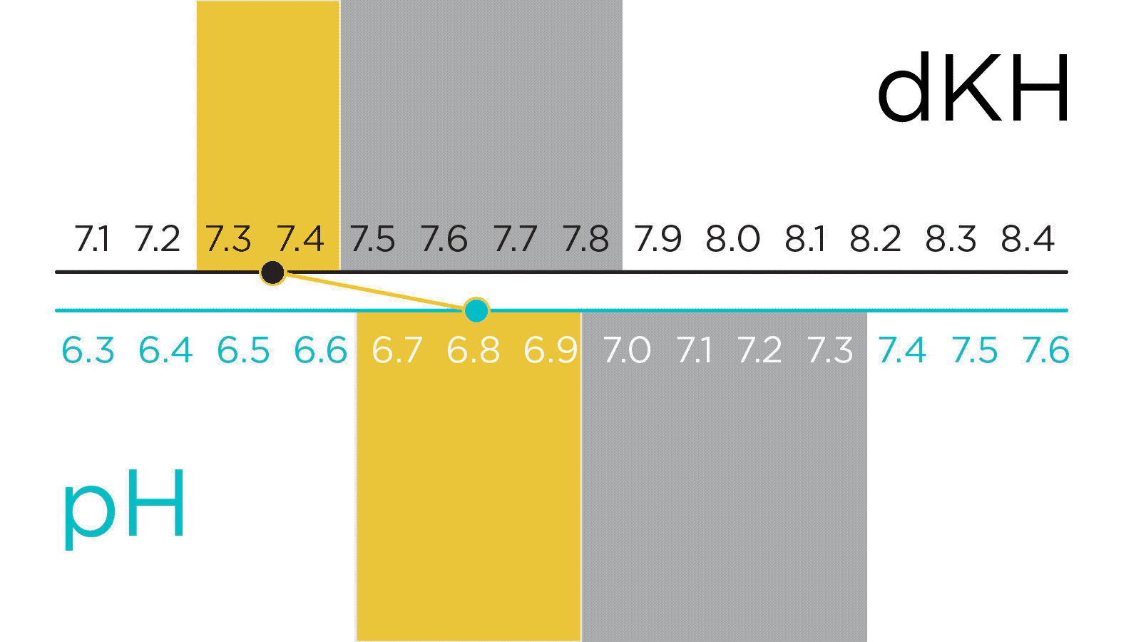

Appendix B: Reactor pH Tracks Alkalinity
Did you know that HYDROS has a feature that monitors the Alkalinity level in your aquarium and automatically adjusts the pH level inside your calcium reactor? It’s pretty cool because the Calcium Reactor media doesn’t melt at a single pH point. Instead, it gradually melts more and more as the pH drops. For instance, when the pH level inside the reactor is high (around 7.2), the media melts at a very low rate. However, as the pH in the water drops and gets closer to 6.7, the media melts at a higher rate. This means that with HYDROS, you can be sure that your aquarium stays in top condition without you having to worry about the pH levels.
The HYDROS Controller activates the Calcium Reactor by turning the CO2 ON/OFF and adjusting the pH level inside the reactor based on the Alkalinity reading. It ensures that the pH level is within the Alkalinity range by dynamically making the pH chase the Alkalinity reading.
If your Alkalinity is high, HYDROS will run the reactor pH at a higher level to “dilute” the effluent’s concentration and “maintain” your Alkalinity. However, if your Alkalinity is low, HYDROS will run the reactor pH at a lower level to “increase” the effluent’s concentration and “raise” your Alkalinity.
By utilizing a “dynamic method,” the HYDROS system can enhance stability by making precise adjustments to your reactor’s pH levels according to the Alkalinity readings.

EXAMPLE: Here is an example of a Calcium Reactor setup using Two Little Fishes Reborn Media:
  • Alkalinity (min and max) range: 7.5 – 8
  • The Calcium Reactor bubble rate is fixed at two bubbles per second.
  • The effluent rate is constant. To shut off the reactor and prevent it from melting media, we turn OFF the pH and allow it to climb up. When it gets above 7.2, the media stops melting.
HYDROS Calcium Reactor OUTPUT setup:
  • pH ON Point: 6.7
  • pH OFF Point: 7.3
  • Alkalinity ON Point: 7.3
    TIP: Due to the delayed readings in the reactor, we need to make the ON point much lower than the actual alkalinity reading we want to achieve. In this case, 7.5 dKH.
  • Alkalinity OFF Point: 7.8
    TIP: Due to the delayed readings in the reactor, we need to make the OFF point much lower than the actual alkalinity reading we want to achieve. In this case, 8 dKH.
Using the numbers above, we have kept Alkalinity between 7.65 and 7.91 throughout the 24 hours.
