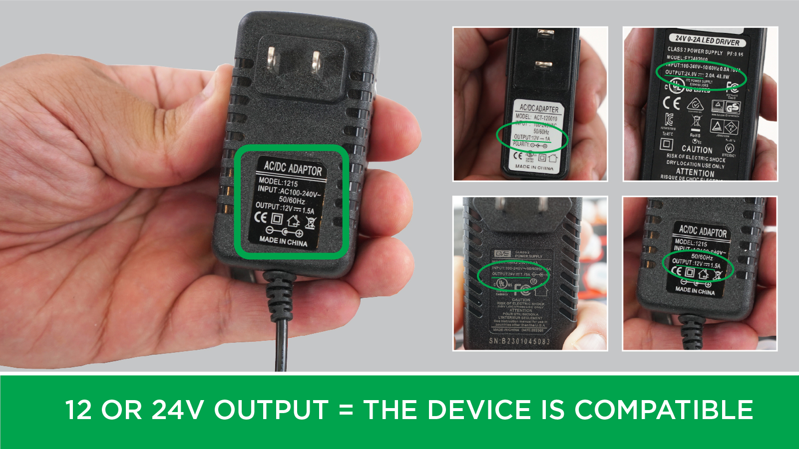

2. What is the OUTPUT voltage on the power supply brick’s sticker?
12 or 24V output = The device IS compatible.
You can typically find the specs on a sticker or a smooth surface on the power supply itself. Look for the OUTPUT section in the specs. If it is 12 or 24V (where V stands for volts), your device is compatible with the Kraken. However, if the output is anything other than 12 or 24, including but not limited to 5, 18, 27, or 36V, it is incompatible with the Kraken. In other words, to work with Kraken, the output voltage must be 12 or 24V.
