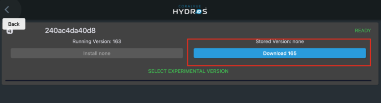

Step 2: Download the Update
The HYDROS control allows you to download the update file WITHOUT installing it. It comes in handy when you’re away and want to download the update, so you can install it right away when you get home. Also, if the download fails, your unit will not lock up. Instead, it will fail the download; you can manually restart it.
TIP: It is best to download the firmware on ALL devices before installing it on ANY device. It will ensure all devices use the same firmware version and prevent incompatible firmware from being deployed across the collective.
  1. Tap on the upper-RIGHT-hand corner of the STATUS screen and select “Device Properties.”
  2. Scroll down and tap on “Firmware Update.”
  3. Tap on the top green button to download the latest release version
    TIP: . If you do not see the
  4. green button or it is grayed out, one of your devices is offline or not connected to Wi-Fi. Scroll down and power-cycle the faulty control. If power-cycling does not resolve the issue, try restarting your Wi-Fi router and access points (pods).
  • Wait for the file to download fully.
