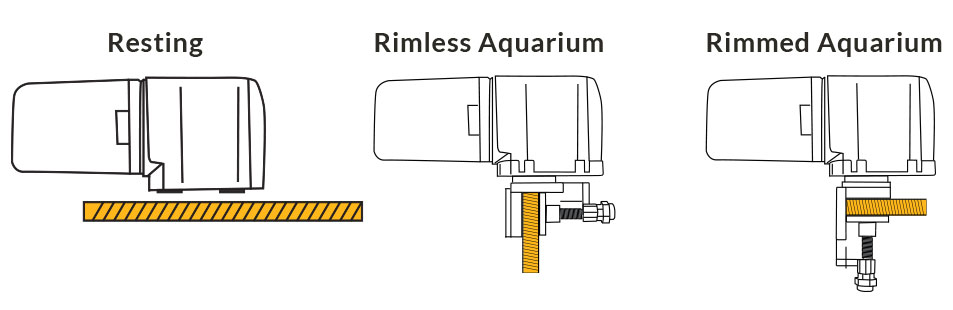

Step 1: Mount the Feeder
The first thing you must do is install the Feeder. The Feeder comes with a mounting bracket that makes installation very easy. You can also use the double-sided tape included if you do not wish to use the bracket.

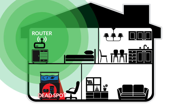

When installing the WiFi feeder, remember that WiFi CANNOT travel through water. Therefore, if you draw a straight line between your WiFi feeder and your router, there SHOULD NOT be any body of water directly in the path. If there is, WiFi will not get through the water, creating a dead spot behind the body of water.
WiFi originates from a single source (the router), with the HYDROS controller located beneath the aquarium. The aquarium obstructs the WiFi signal, leading to a dead zone that causes intermittent or lost connectivity.

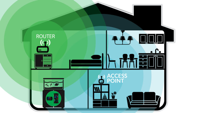

The WiFi signal originates from two sources. While the aquarium water blocks the router’s signal, HYDROS still has a direct line of sight to the living room access point, ensuring no HYDROS WiFi connectivity issues.

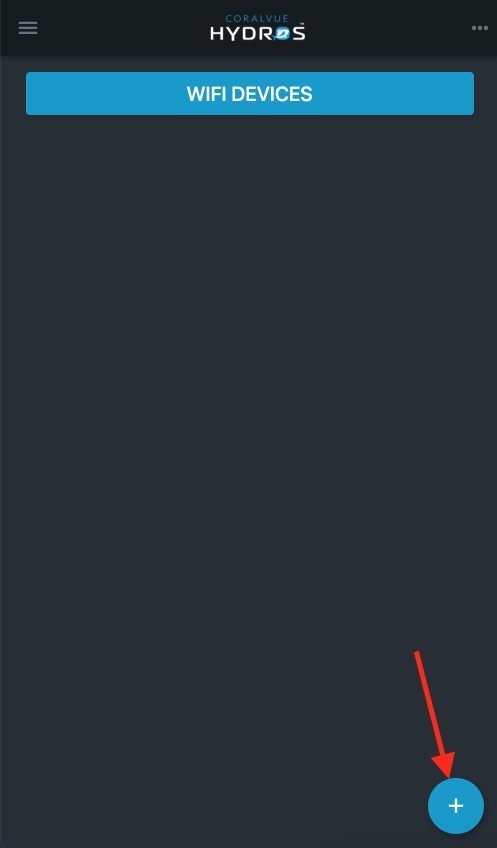

- From the Status screen, tap the three horizontal dots next to the WiFi Devices label.
- Select “Add New WiFi Device”

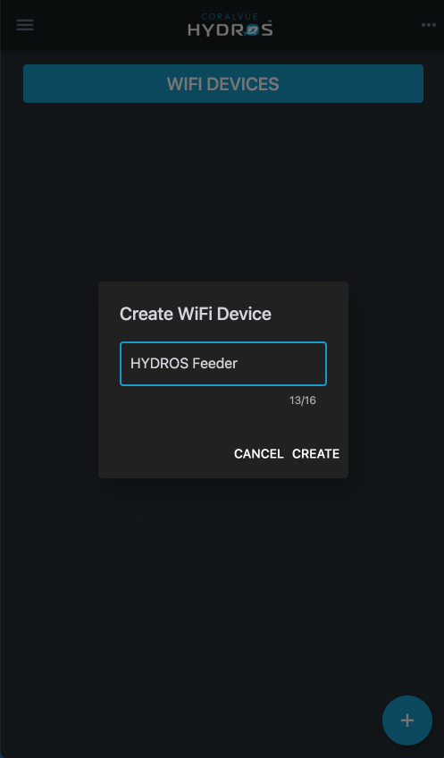

- Click on the “+” symbol on the bottom right.

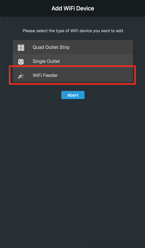

- Enter the name you wish to assign to the FEEDER and tap on “Continue.”
- Select “WiFi Feeder” as your WiFi Device

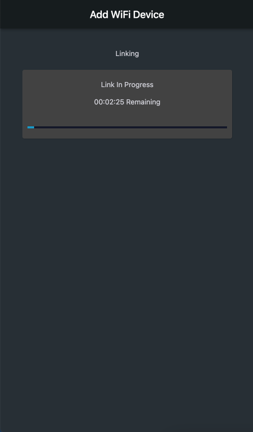

- NOW connect the Feeder to power AND ensure that the blue light at the top blinks fast (more than once per second). Please refer to Appendix B below if the Feeder light does not blink or is blinking slowly (less than a blink per second).
WARNING: You must proceed with the next item in this list WITHIN 10 seconds of step 4.

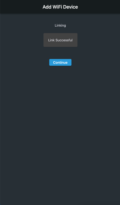

- Go back to the app and hit “Continue.” Next, the Control scans your surrounding areas to find the Feeder (This process can take up to 1 minute). When complete, the Feeder light will stop blinking and turn solid BLUE.

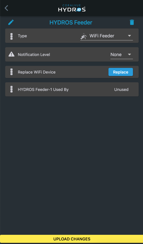

After successfully connecting your WiFi feeder, the next step is configuring it.
- Type: Here, select “WiFi Feeder.”
- Notification Level: You select the type of notification you want when the Control cannot connect to the Feeder via WiFi.
- Replace WiFi Device: This button lets you replace the Feeder with a new one, or update the Feeder’s WiFi credentials. It allows you to bring in a new device without needing to reconfigure it.
- They are used by: An easy way to know which OUTPUT uses the Feeder.
After configuring the Feeder, don’t forget to upload your changes.
