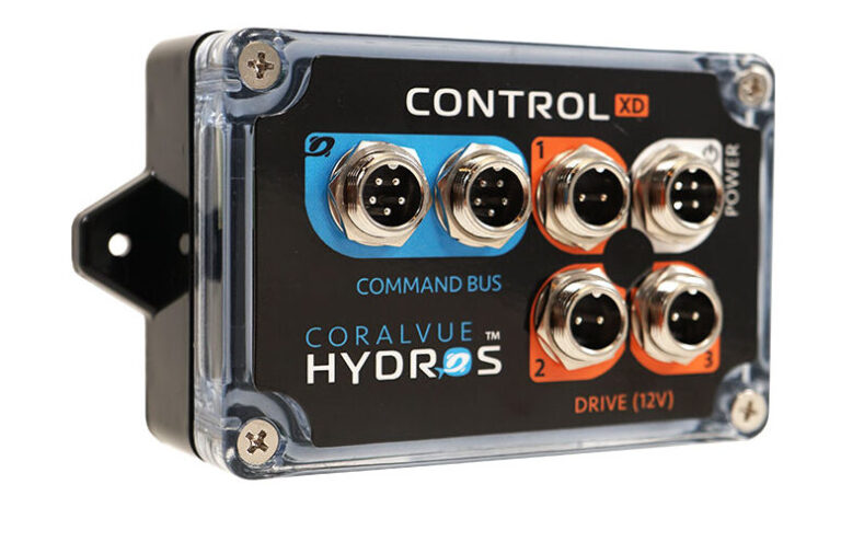

Device Features
  • Command Bus Ports (Blue): 2
  • 24V Power INPUT: 1
  • 12V Drive Ports (Orange): 3
    • Max Load: 2.5A each, 4A all ports.
Important Information:
  • WiFi Compatibility: 2.4GHz ONLY
  • IP Rating: 65 (dust and splashproof – NOT waterproof)
  • Mounting Bracket: Yes
    WARNING: Mount the device permanently to an elevated wall or side panel. NEVER place the unit on the floor. Ensure all cables have proper drip loops.
