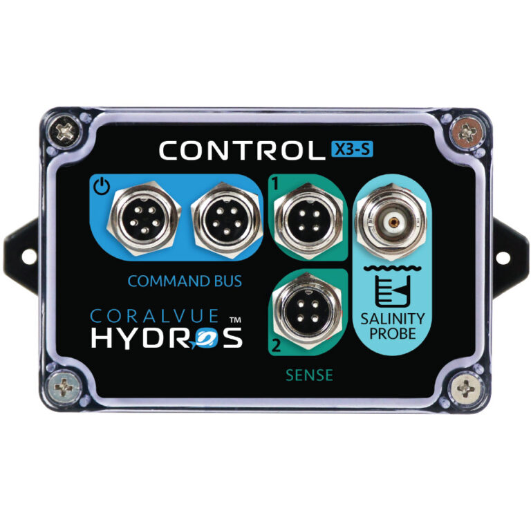

Device Features
  • Sense Ports (Green): 2
  • Conductivity/Salinity Probe Ports (Light Blue): 1
  • Command Bus Ports (Blue): 2
Important Information:
  • WiFi Compatibility: 2.4GHz ONLY
  • IP Rating: 65 (dust and splashproof. NOT waterproof)
  • Mounting Bracket: Yes
    WARNING: Mount the device permanently to an elevated wall or side panel. NEVER place the unit on the floor. Ensure all cables have proper drip loops.
