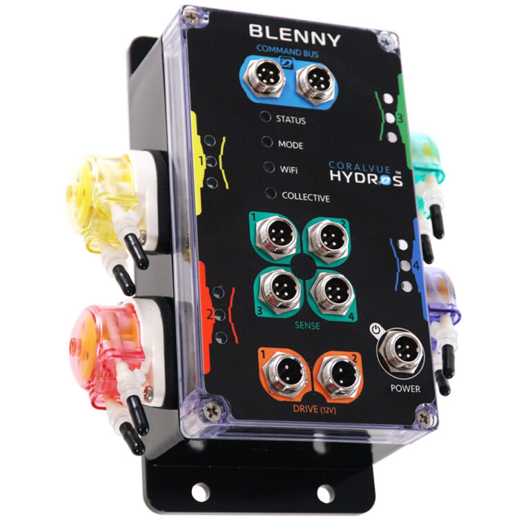

Blenny Aquarium Controller
Device Features
  • Command Bus Ports (Blue): 2
  • Sense Ports (Green): 4
  • 12V Drive Ports (Orange): 2
  • Dosing Pumps: 4
    • Speed Range: 25, 40, 55 mL/min
    • Run Constantly: No
    • Tubing Life: ~ 1000 hours
Important Information:
  • WiFi Compatibility: 2.4GHz ONLY
  • IP Rating: 65 (dust and splashproof. NOT waterproof)
  • Mounting Bracket: Yes
    WARNING: Mount the device permanently to an elevated wall or side panel. NEVER place the unit on the floor. Ensure all cables have proper drip loops.
