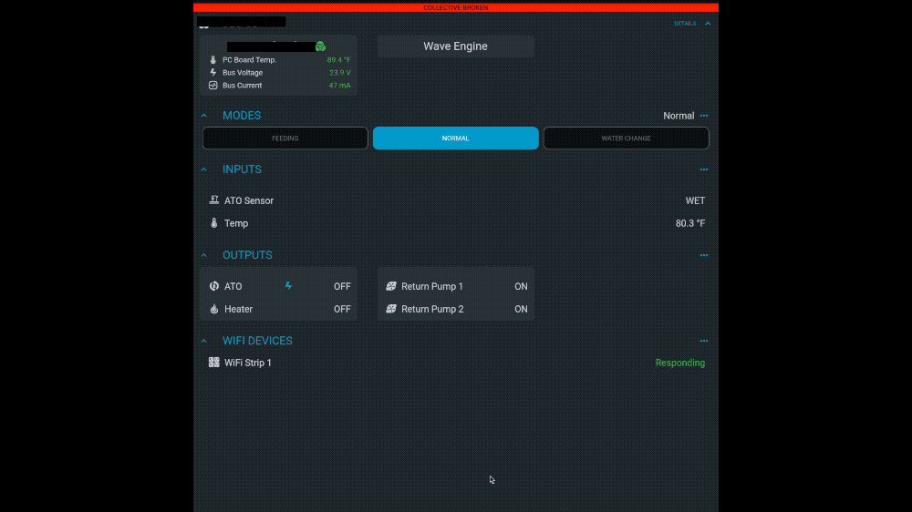

WARNING: All Collectives must have at least ONE terminator installed at all times. If not, the collective will not work. Here is an image of what the collective looks like when a terminator is NOT installed.
