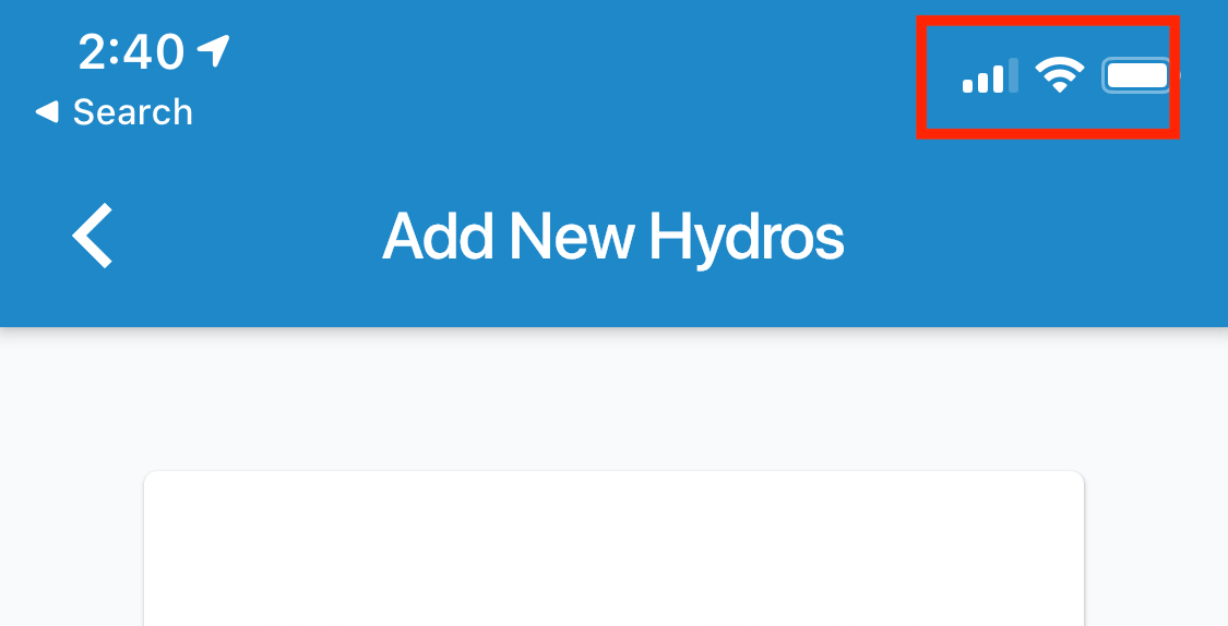

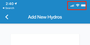

    WARNING: If you are using an iPhone, please wait until you see the WiFi icon on the upper right-hand corner.  It may take up to 60 seconds to establish a connection.
